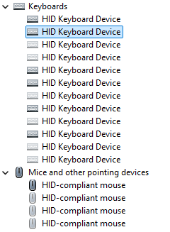

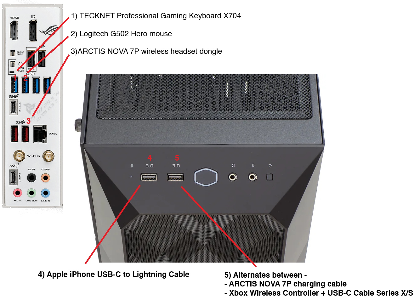

  3. L 5 Reputation points

  4. David-M 99,515 Reputation points Independent Advisor
    2025-12-11T16:53:32.0166667+00:00
    Thanks for the details.
    The minidump mentions a driver related to HID, so only the mouse, keyboard, and controller are suspected. The other devices do not appear to be related.
    I suggest you check for updates to your keyboard and mouse drivers. Try uninstalling the current driver and installing the updated one.
    If the problem persists, if you have any management software or other software related to the keyboard or mouse, I suggest you uninstall them and see if the system works stably.
    If the problem persists, try leaving the controller disconnected to see if the system becomes stable.
