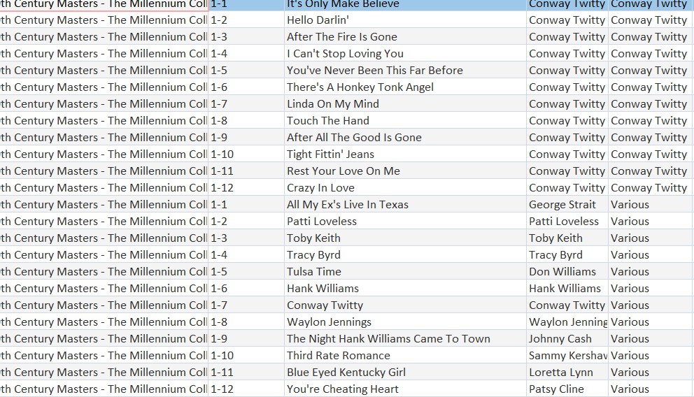

I do get a bit of an access provided reason stating "The expression On Format you entered as the event property setting produced the following error: A problem occurred while MS Access was communication with the OLE server or Active X Control. See photo

    There was also a question regarding if the underlying query was returning duplicates or not. It does by design. If an album is from a single artist then the name would repeat for every title on that album becuase every title is by that artist. (Hence the need to surpress the field and use the Album artist vice Artist). Conversely, if the album is a complation of various artists, the the artist name would "repeat" but the data would be unique individuals.

    Artist and AlbumArtist must be the names of controls in the detail section. This will hide the Artist control if the value of the AlbumArtist control in the same section is 'Various'. I notice that in the rows where the alubum artist value is 'Various' the value in the third column is the name of the artist, while in other rows it is what I assume to be the name of the track. Different attribute types should not be in the same column, that is a fundamental principle of the database relational model.
    Please post the SQL for this query. That will tell us from where the values in each column are derived, and hopefully address the issue of the duplication of values. This will probably be along the general lines of the queries I described in my earlier reply. Duplication in a query's result table is very common, and legitimate where data is not being aggregated over subsets of rows. The place to suppress the duplication is in the output medium, usually a report.
